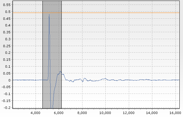

Is there a way to have a TColorLineTool only visible when it intersects a ColorBand?
If you look at the attached image, I would like the orange line to be only visible within the gray area (ColorBand).
Chart

Hi Charles,
The easiest solution would be to draw the horizontal line manually. Ie:
uses Series, TeeTools, TeCanvas;
  Chart1.View3D:=false;
  Chart1.Legend.Visible:=false;
  Chart1.AddSeries(TFastLineSeries).FillSampleValues;
  with Chart1.Tools.Add(TColorBandTool) as TColorBandTool do
    Axis:=Chart1.Axes.Bottom;
    StartValue:=10;
    EndValue:=15;
    Transparency:=50;
    Color:=clGray;
var StartX, EndX, PosY: Integer;
  with Chart1[0].YValues do
    PosY:=Chart1.Axes.Left.CalcPosValue(MinValue + (MaxValue-MinValue)*2/3);
  with Chart1.Axes.Bottom, (Chart1.Tools[0] as TColorBandTool) do
    StartX:=CalcPosValue(StartValue);
    EndX:=CalcPosValue(EndValue);
  with Chart1.Canvas do
    Pen.Color:=clRed;
    Line(StartX, PosY, EndX, PosY);

thank you for your reply. But I still need to be able to drag up or down that line. This line represent a user adjustable setting.
Is there any way I could do that?

Hi Charles,
I'll add to the wish list the possibility to set a minimum and a maximum for the TColorLineTool (TV52016498).
In the meanwhile, I see two options:
- Improve the example above to add the features you require. You could use OnMouseMove event to change the Cursor to crVSplit when the mouse is over the line; and you could use the OnMouseDown, OnMouseUp and OnMouseMove events to implement the dragging feature.
- If you are SourceCode customer (I believe you are), you could modify the TColorLineTool to behave as you want. I guess with some modifications at the TColorLineTool.DrawColorLine method from TeeTools.pas would be enough for you.
