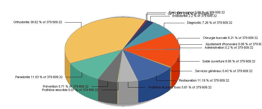

I use TeeChart standard v2011.03.32815 32 bit VCL include in Report Builder 14.04 build 106 with Delphi XE2 on Windows 7.
When I print, a pie chart containing several labels, some of them overlap. What should I do to not overlap label?
Best regards.
Report Preview

Have you tried manually positioning the marks like in the example here?
http://www.teechart.net/support/viewtop ... 1842#p1842

The component does not have a procedure or property to position the labels automatically to prevent overlap?
Best regards!
Re: Label overlapping in report
Post by Yeray » Mon Jan 28, 2013 1:57 pm
The component tries to prevent the marks overlapping. However, we don't want to introduce a very complex or heavy internal algorithm that could affect the performance.
