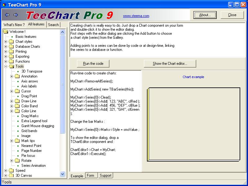

I am running Borland C++ Builder 6 (Service Pack 3). The demo looks the same and has exactly all the same new features listed whether I run the TeeChart 7, 8, or 2012 new features demo. Here is a screenshsot of the 2012 demo when I run it on my computer.
As you can see, All features\Tools\SubChart does not show up.

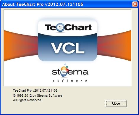

Here is the About box:
I think I may try unistalling all the TeeChart versions and reinstalling TeeChart 2012. If you can provide any additional insight, I would appreciate it. Otherwise, I will try unistalling and reinstalling TeeChart. I'll let you know what I find.

Re: New features demo not showing latest features
Post by Narcís » Fri Jan 11, 2013 2:17 pm
Hi Scott,
The problem here is that BCB5 and BCB6 demos weren't upgraded. Therefore they still include the demos from the older versions but both IDEs have the full functionality of v2012, just out of date demos. It was considered that upgrading those demos involved a lot of work not worth for the few users using those environments nowadays. Apologies for the confusion this may have caused.
