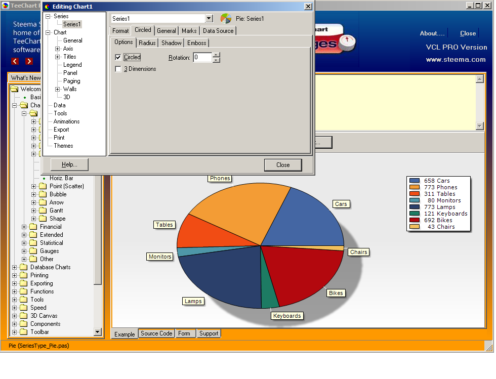

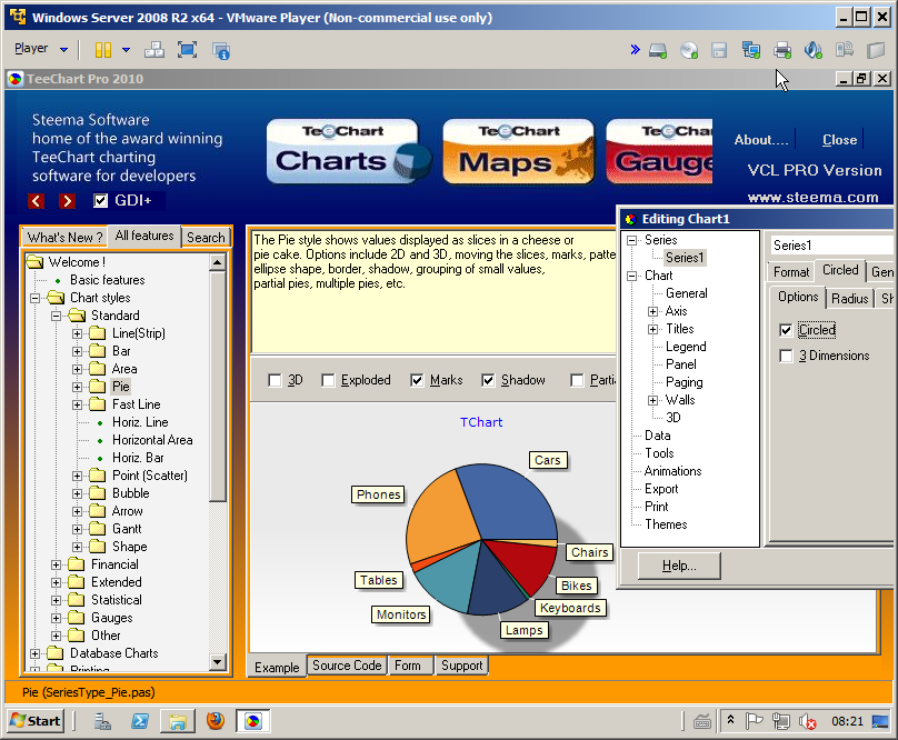

We have an important problem regarding Teechart and Pie series. The fact is that the propertie Circled doesnt work on
Windows Server 2008 R2 x64, we can reproduce the problem on several machines here. Instead of making a perfect circle,
it makes an ovale. It looks like the Pie have the 3D style with 0 elevation, and the 3d properties is disabled....
On Windows 7 x64 and Windows XP, everythings perfect.
Here's an example of the problem using the demo provided on this website, Tee9New.exe from here : http://steema.com/download/vcl
The test was performed on Windows 7 x64 and Windows Server 2008 x64, on the same resolution (1920x1080) with all windows Update done.
The only properties that was changed are disabling 3D mode and Circled = true.
Look for the attachments for picture of the exact problem.
Thanks in advance, we must find a solution for this as a lot of our customers are on Windows Server 2008.

- Windows Server 2008 x64
- Windows Server 2008 x64.png (100.39 KiB) Viewed 5097 times
- Windows 7 64 Bits
- Windows 7 64 Bits.png (168.75 KiB) Viewed 5076 times

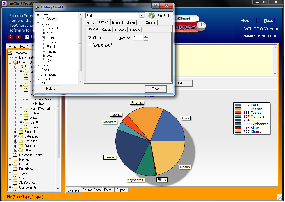

Sorry for the delay. I have tried reproduce your problem with last version of TeeChartVCL(build 2012.07.121105 ) , Windows Server 2008 Datacenter without Hyper-V x64 and All features\Chart Styles\Standard\Pie and the problem doesn't appears for me. Please remove the TeeChartVCL of your computer, reinstall last version and check again if your problem persist.
The result I have gotten is next:

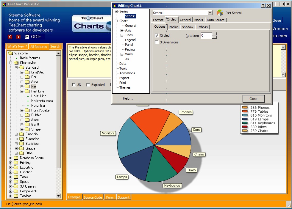

Hi again,
Here is what I get in the following environment:
- VMPlayer 5
- Windows Server 2008 R2 with Service Pack 1 x64 (en_windows_server_2008_r2_with_sp1_x64_dvd_617601.iso)
- Tee9New demo from the "TeeChart compiled demo" here
I've just opened the "All features\Chart Styles\Standard\Pie" demo in this environment, set the chart to 2D and selected the Circled property in the Editor.
- VMPlayer 5
