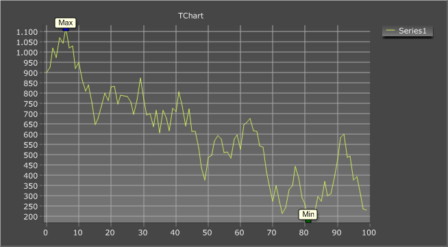

I know I can detect the maximum and minimum values of the bottom axis (or any axis) by using
Chart.BottomAxis.Minimum
But how do I find the visible max and min values and not the whole extent of the series?
Bruce.
Re: Find the visible max and min extents of an axis
Post by Yeray » Fri Dec 21, 2012 11:57 am
Hi Bruce,
I've made an example project to show you how to use FirstValueIndex and LastValueIndex to calculate the Minimum and Maximum values in the series.
MinAndMax.zip
(2.07 KiB) Downloaded 627 times
