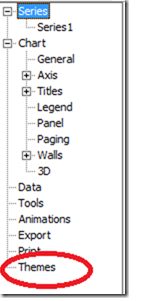

I use the TchartEditorPanel to allow the users to customize the charts.
See the structure below:
Pic1
I’m currently converting my application to Win64.
But the VCLTee.TeeDesignOptions unit is not available in the 64 bit version.
And when I remove the VCLTee.TeeDesignOptions unit from the uses list. Then “Themes” dissapear from the chartEditor structure

Regarding your question, the same was answered and replied some time ago here.
Just add the TeeThemeEditor unit to the uses clause.
