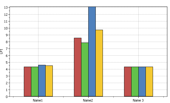

Hello all,
I am completely stack with this so I need a fresh look from someone else!!! I created this chart, works as I want to but it looks like I cannot hide one name group, for example I need the user to be able to show/hide Name1 or Name2 etc. Any help please !!!!

Hi Johnnix,
Could you please clarify if you want to hide just the "Name2" text, or also the bars above it?

Post by johnnix » Wed Nov 14, 2012 7:36 am
I need to hide both label and bars :)

Hi Johnnix,
Then, I'd work with null points. Known the ValueIndex to hide, you can loop all your series and set as null:
    Chart1[i].SetNull(ValueIndex);

Hi again,
In addition to the above, when I tried the following code, where I have 5 TBarSeries with 5 values each and I want to hide the ValueIndex=2:
uses Series;
var i, j, ValueIndex: Integer;
  Chart1.View3D:=false;
  for i:=0 to 4 do
    with Chart1.AddSeries(TBarSeries) do
      FillSampleValues(5);
      Marks.Visible:=false;
      for j:=0 to Chart1[i].Count-1 do
        Chart1[i].Labels.Labels[j]:='Name'+IntToStr(j+1);
  ValueIndex:=2;  //ValueIndex to hide
I've seen the bars with ValueIndex=2 are correctly hidden, but not the bottom axis label.
However, you can always hide those labels in the bottom axis with no visible value associated:
procedure TForm1.Chart1GetAxisLabel(Sender: TChartAxis;
  Series: TChartSeries; ValueIndex: Integer; var LabelText: String);
var i: Integer;
  if (Sender=Chart1.Axes.Bottom) and (ValueIndex>-1) then
      if Chart1[i].IsNull(ValueIndex) then
        if i=Chart1.SeriesCount-1 then
          LabelText:='';
      end
        exit;
And the above seems to work fine for me here.
