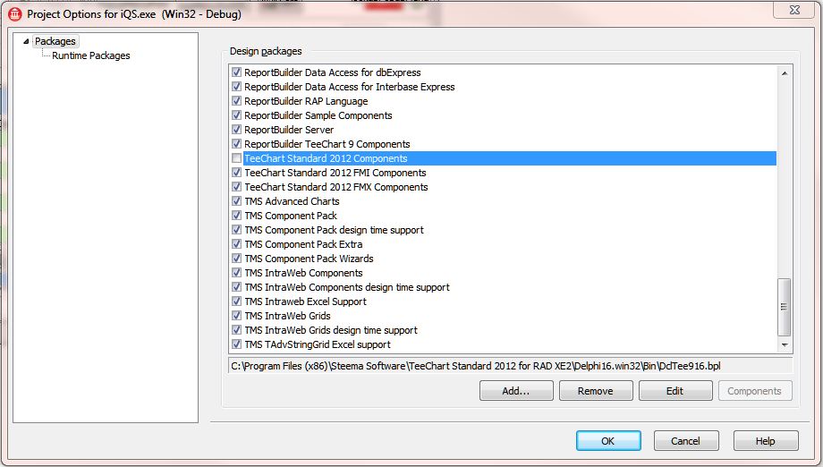

coryb
Posts: 4
Joined: Tue Dec 18, 2012 12:00 am
Re: TeeChartStandard v2012 XE2 Installation failed
Post by coryb » Wed Dec 19, 2012 3:21 pm
They all point to the Steema folder as you can see... and I have rendering problems as noted in post made a few moments ago...
Post by Yeray » Wed Dec 19, 2012 4:04 pm
In that image I see the "TeeChart Standard 2012 Components" package points to the TeeChart Standard installation, but this package is unselected.
If, when you select it, you get any error indicating there is a conflict with another package, please search for the package that enters in conflict with it, and unselect it. I see you have some 3rd party tool packages installed. They could be using the TeeChart Standard package shipped with the IDE, so please try to unselect them. If you find the conflict is caused by a 3rd party tool package, please contact the manufacturer to get instructions on how to rebuild it to make it use the TeeChart Standard installed version.
