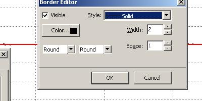

In the case of linepen I can just the BorderEditor to change the line - for instance to make it dashed etc... (see attached photo)
Is there any possibility to use a simlar dialog box to change the point of the TPointSeries?
I know I can use the the ChartEditor - but it is so complicated and contains too many details...
Isn't there a possibility to change just the point of the TPointSeries itself? (change it from a square to a circle to a triangle, start etc?) similar to the border editor?
Actually, what I'm looking for is a predefined combobox where you can choose between the appearance of the TPoint i.e., square, circle, triangle, star etc
