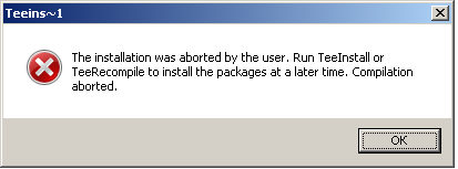

I've just tested pre-release for XE3, at the end of installation I got message: "The installation was aborted by the user. Run TeeInstall or TeeRecompile to install the package at a later time . Compilation aborted.":
Error message

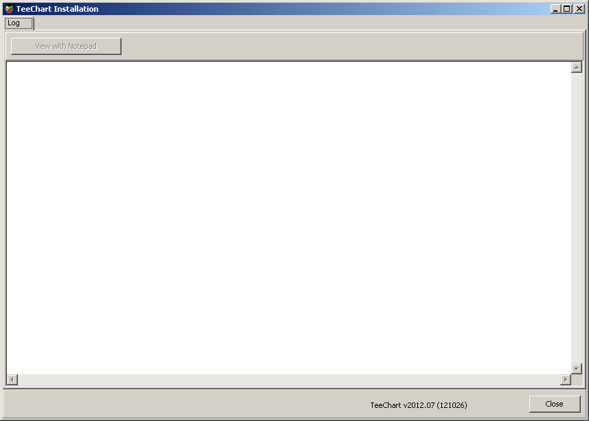

The log file is empty:
Empty log file

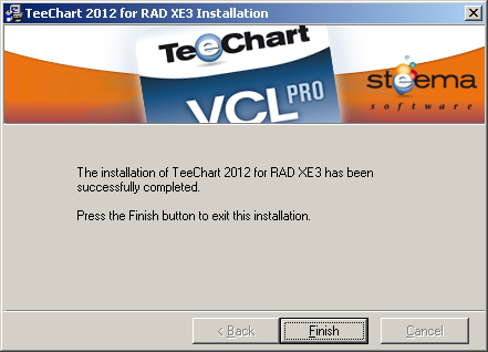

After show message:
The installation successfully completed
After that I tried to start TeeInstall and got message:
"Do you want to INSTALL TeeChart Pro? 2012 in RAD XE3.Win32 v17 Architect(RAD XE v10 Architect)(C++)?"
After pressing of the OK button I got the same first message (The installation was aborted by the user .... Compilation aborted.).
