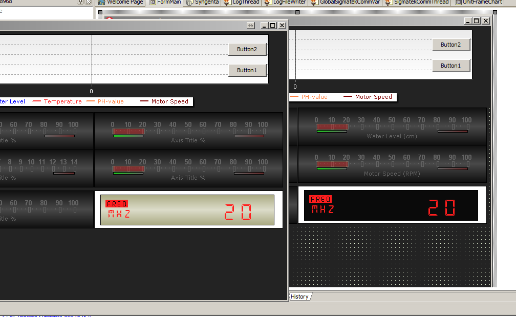

Difference
Left is compiled, right is designer.

You're right. It seems the properties set at designtime in the Gradient tab aren't correctly serialized.
I've added it to the wish list to be revised for future releases (TV52016362). In the meanwhile, you could set them at runtime. Ie:
    Series1.Face.Gradient.Visible:=false;
Or:
    Series1.Face.Gradient.StartColor:=clBlack;
    Series1.Face.Gradient.MidColor:=clGrayText;
    Series1.Face.Gradient.EndColor:=clBlack;
