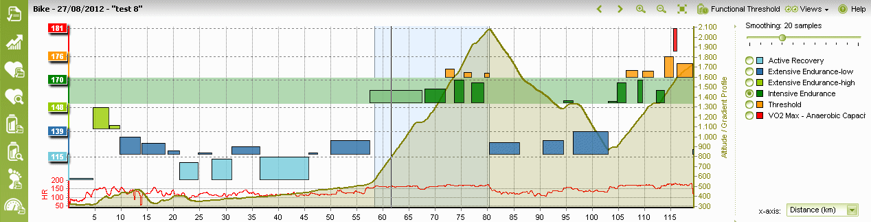

In the attached screenshot there are TAreaSeries with custom vertical axes created at runtime.

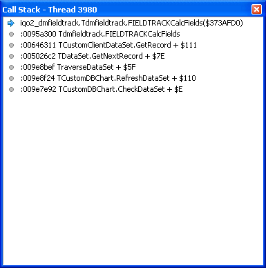

However, when I debug on the line Series.Free I get the call stack as in the attached file.
The series I am destroying is not linked to a datasource though, the points are just added manually.
Edit: when i create the series and populate them, it's instantaneous, the delay and flicker only occurs when destroying.
It seems the data for other series linked to a datasource on the same chart is being refreshed for some reason ?
I tried setting all chart series to Active=False, but seems the problem remains.

Apparently, the culprit is the DBChart.AutoRefresh property.
When I change the Begin/End update as below, the chart refreshes instantly when switching to / creating / destroying groups of series.
The question is why the chart refreshes the data when a series is destroyed which is not even linked to the data source ?
Also, it seems when disabling/enabling AutoRefresh as in the code below, I will need to call CheckDataSource for each series as well, not just calling DBChart.RefreshData as it does not seem to work. Some of the series remain blank. Seems like a lot of refreshing to do just to destroy a series though..
