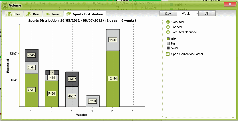

I have a application where I show volume distributions using stacked bars, as in the attached screenshot.
I am displaying the volumes using the Marks but I am having some difficulty getting them in a readable position.
Ideally I would like to have the Marks centered on each bar value.
Is there any way to achieve this ?
Thank you.

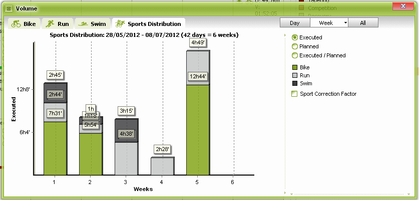

I got a access violation because there are also null points so the mark position object can be nil.
I have a central procedure called RefreshChart. All the series are created at runtime depending on the settings the user selects.
The very first time when the form is created and the chart is refreshed, the marks still appeared in the old position so I added a Invalidate to refresh it.
After that, I used chart after draw and check for the flag if it's refreshed and then call RefreshMarks.
I also accounted for the height of the mark itself to position it.
Wouldn't barHeight always be the same as barBounds.Bottom - barBounds.Top ?
Seems to work okay now, apart from the shoehorn to refresh it the very first time.
