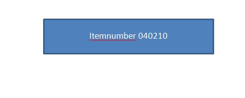

Is it possible to add text "inside" a Gantt figure similar to the figure I have attached?

Yes, you can simply make the marks visible and transparent:
  Chart1.View3D:=false;
  with Chart1.AddSeries(TGanttSeries) as TGanttSeries do
    FillSampleValues(5);
    Pointer.Size:=10;
    Marks.Visible:=true;
    Marks.Transparent:=true;
    Marks.Font.Color:=clWhite;
