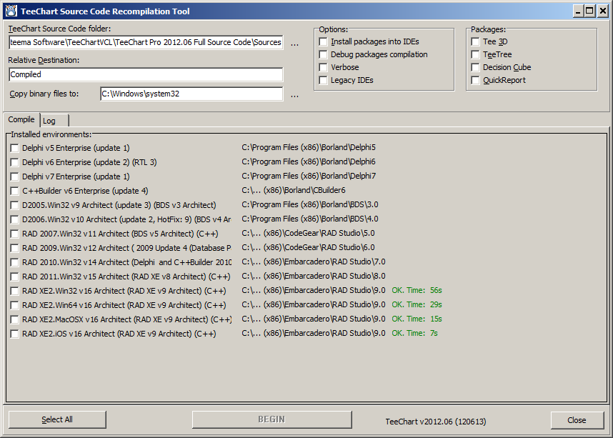

This is how it ends for me selecting the 4 Rad XE2 environments (Win32, Win64, MacOSC and iOS), and nothing else selected:

Here are the settings I am using:
