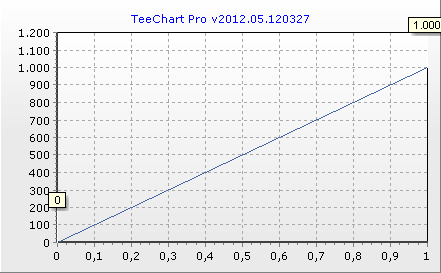

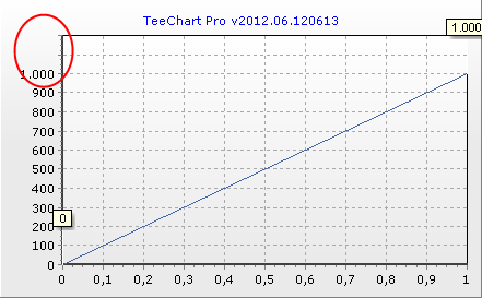

I have revealed an incompatibility between two versions of TeeChart 2012 Pro. The earlier version (05.120327) displays axes labels properly, the later (06.120613) not.
I prepared simple demo applications (compilled under different wersions of TeeCart) showing this effect. Unfortunaltelly, I cannot upload them because file size limit. Please compile the source code under both versions and oobserve differences. Upper labels on the left axis, are displayed incorrectly when compilled under the newest version. When series marks are visible then more labels are not shown. Unfortunatelly, I did not tested another axes, but is very likely that the same effect will be observed.

I see it now. I've added it to the defect list to be revised asap (TV52016272).
FYI: The simpler code to reproduce it would be this:

I would like to turn your attention on another effect of this bug: when the axis maximum is rounded and the highest data value is lower than the rounded maximum then the last label do not appears too. I hope you will fix the both effects.

Please use the following code:
Series1.Add(0);
Series1.Add(945);
Chart1.LeftAxis.MaximumRound:= true;
The older release shows the tick and label "1000" on top of the left axis (as one can expect), the new release shows the tick but not the label.
