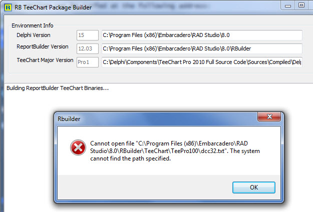

It installed fine - but when I tried to install the Report Builder components - I get an error. It tells me that it cannot open file dcc32.txt in the c:\Program Files(x86)/... directory structure. And of course it is correct - because it is not there.
Yet in the TeeChart directory int he RB TeeChart Package Builder - it shows the proper directory of c:\Delphi\...

- Error Message when installing RB
- TeeChartRBIssue.jpg (88.65 KiB) Viewed 8921 times
