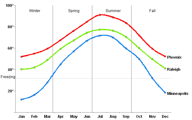

To help people understand charts, authors often add vertical and/or horizontal lines and explaining text. The attached pictures shows such an example:
  • vertical lines ("winter", "spring", "summer", "fall")
  • horizontal line ("Freezing")
Can you please tell me, if and how this is possible with TChart?
Dirk.
Re: Vertical and horizontal lines with text
Post by Yeray » Tue Jul 03, 2012 10:18 am
Hi Dirk,
You can use TColorLineTool(s) to draw the lines and TAnnotationTool(s) to draw the texts.
I'd suggest you to take a look at the features demo program, you'll find example of both tools in it.
