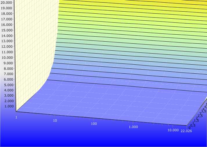

I have a chart with an ISO surface.
The bottom axis is logarithmic with min=0, max=24000
As shown in the picture
the bottom axis does not show the usual start label min=1 and max=24000. Furthermore the ticks below 100 are also not displayed.
IMO there is no setting to create a correctly displayed axis.
Also the displayed surface seems to have triangulation problems.

Post by Yeray » Fri May 18, 2012 3:13 pm
Hi Uli,
ulibru wrote:the bottom axis does not show the usual start label min=1 and max=24000
When the axis is set to be logarithmic, the increment for the labels is also logarithmic and with base 10: 1, 10, 100, 1000.
If you want you can change the LogarithmicBase. Otherwise, could you please explain how would you expect it to work?
ulibru wrote:Furthermore the ticks below 100 are also not displayed.
You are right, I've added it to the wish list to be revised (TV52016193).
ulibru wrote:Also the displayed surface seems to have triangulation problems.
I'm afraid this a known problem already in the defect list (TV52013073).

I don't want to change the logarithmic base. I just miss the standard display of 1 for the lowest label (as usual with 2D charts).
Of course a label display of the max limit (here e.g. 24000) with the standard 1, 10, 100, 1000, 10000 labels would be the cherry on the icecake (also with all other charts).

Re: Wrong axis display with ISO surface / Trianulation problems
Post by Yeray » Mon May 21, 2012 2:28 pm
Hi Uli,
Have you tried using custom labels?
  with Chart1.Axes.Bottom.Items do
    Clear;
    Add(1,'1');
    Add(10,'10');
    Add(100,'100');
    Add(1000,'1.000');
    Add(10000,'10.000');
    Add(24000,'24.000');
ulibru
Post by ulibru » Tue May 22, 2012 8:06 am
Yeray,
now I have tried :D
Your proposal allows to set custom axis labels. Though this needs some extra effort in case of axis zooming, e.g. display of range from 150 to 3800. It needs some logic to create nice labels.
But beside of the label setting I have noticed a strange behaviour of the minor ticks when using custom labels. So there are new minor ticks created on the logarithmic scale as a side-effect. How to avoid this?
Uli

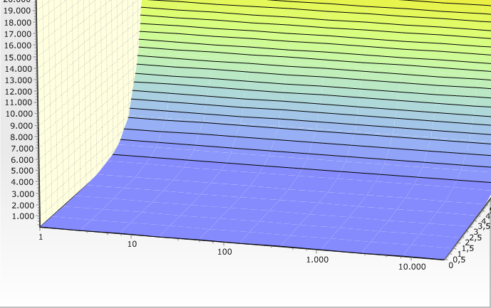

Post by Yeray » Tue May 22, 2012 4:20 pm
Hi Uli,
ulibru wrote:But beside of the label setting I have noticed a strange behaviour of the minor ticks when using custom labels. So there are new minor ticks created on the logarithmic scale as a side-effect. How to avoid this?
I'm trying to reproduce it with the code below but I don't see anything strange in the minor ticks:

Do you see any relevant difference between the code above and what you are doing?

Post by ulibru » Tue May 22, 2012 5:48 pm
Yeray,
I have used your example with following modifications:
length of bottom ticks = 20
length of minor ticks = 10
minor ticks count = 8 (8 minor ticks between major ticks 10/100 = position 20, 30, 40, 50, 60, 70, 80, 90 with logarithmic axis)
This is just for better view.
Your code:
    Clear;
    Add(1,'1');
    Add(10,'10');
    Add(100,'100');
    Add(1000,'1000');
    Add(10000,'10000');
Result = ok
One line added to code:
    Clear;
    Add(1,'1');
    Add(10,'10');
    Add(100,'100');
    Add(1000,'1000');
    Add(10000,'10000');
    Add(Chart1.Axes.Bottom.Maximum,System.SysUtils.Format('%1.0f',[Chart1.Axes.Bottom.Maximum]));
Result = wrong !
Please see ticks before and after 10000 !
Uli
Post by Yeray » Wed May 23, 2012 9:39 am
Hi Uli,
I see it now. Thanks for the explanation.
The MinorTicks drawn for the last tick (22026) are calculated using an increment that depends on the LogarithmicBase (10). If I'm not wrong, you are a source code customer, so feel free to explore the exact calculation process in the ProcessMinorTicks procedure, in TeEngine.pas.
I've added to the wish list the possibility to study this further (TV52016198). But at this moment I'm afraid I'm not sure about how the MinorTicks should be drawn in an interval that doesn't match the LogarithmicBase, in a Logarithmic axis.
