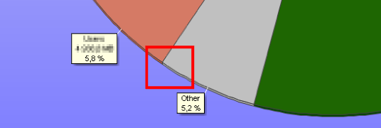

Using a "Chart3DPercent" of "1" leads to a very small 3D effect, which is getting worse when increasing the size of the chart (See attachment "Pie2DIssue.png")
In former version of TeeChart Pro you could at lease use a "Chart3DPercent" value of "0", which prevented this effect.
Do you have any idea/workaround for us to prevent this?
