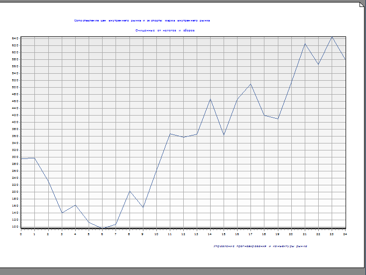

Chart1.Title.Alignment := taCenter;
Chart1.Foot.Alignment := taRighJustify;

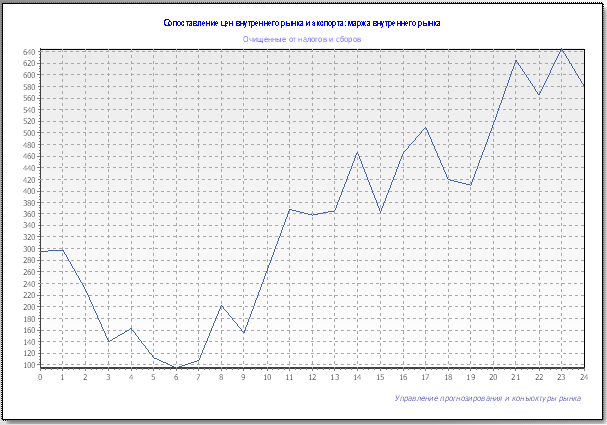

ChartPreview display everything fine.
But after printing to printer or to PDF-file alignment of Title or Footer is wrong.
This is PDF. Look to the footer and title
TChartPreview display correctly

Please!
Sample project and two screenshots.

Re: Title and Footer alignment not correctly printing
Post by Yeray » Tue Apr 10, 2012 11:46 am
Hi Mike,
You are right. I could reproduce it so I've added it to the defect list to be revised for future releases (TV52016149).
