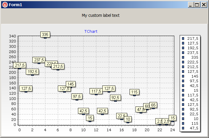

Form1.Scaled:=false;
still gives me a bigger label text in 125% than in 100% mode:
125% text size
100% text size

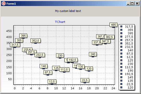

in your attachments there is form.scaled to true
setting it to false give me this
as you see with 120dpi the label "My custom label text" is alway the same dimension as 96dpi, the marks and the legend of the chart instead grow.
I use Delphi XE and teechart pro 2011
If your label "My custom label text" grow in dimension with 120dpi (or 125% in windows 7 style) is because you haven't set form.scaled to false
it's a standard function in delphi and have alvway worked in all versions, so it's not normal that in your system this option don't work
set it in design time, not runtime
