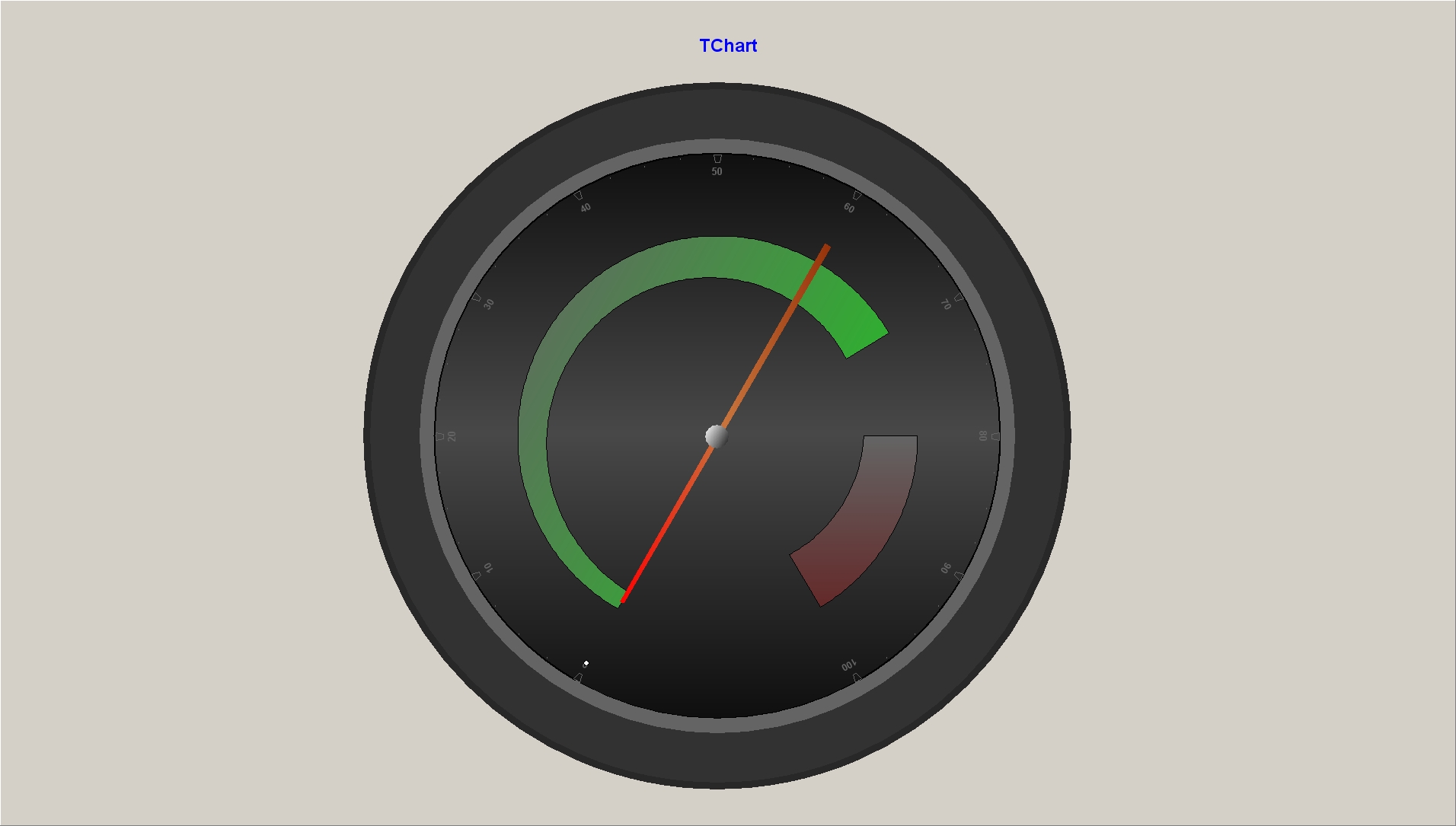

How do I change the increment size in this TGauge?
I have tried but it doesn't work:
Chart1.Axes.Left.Increment := 50;
How do I change the size of the green and red colors in the interior of the Gauge?? I have marked the red area which I would like to change the apperance of...

How do I change the color of the white dot indicating the value of the Gauge ??

How do I change the color of the red and gree areas?
Re: Taguge
Post by Yeray » Wed Mar 28, 2012 2:23 pm
Hi Friis,
The following seems to work fine for me here:
uses TeeCircularGauge;
  with Chart1.AddSeries(TCircularGauge) as TCircularGauge do
    Axis.Increment:=5;
    EndPoint.Color:=clRed;
    GreenLine.Gradient.Visible:=false;
    GreenLine.Color:=clYellow;
    RedLine.Gradient.StartColor:=clYellow;
    RedLine.Gradient.EndColor:=clMaroon;
