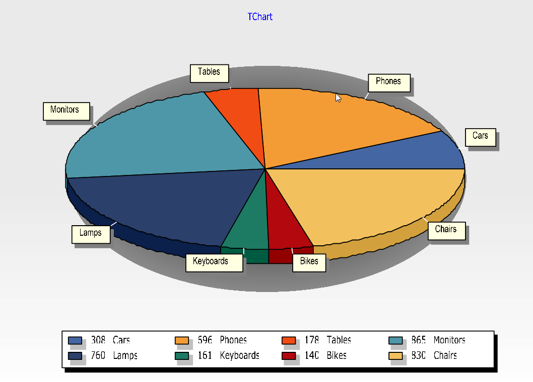

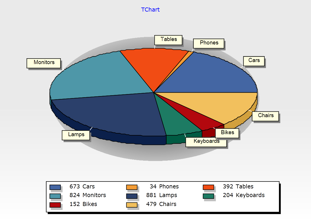

I encountered an issue whith the fonts when printing with TeeChart Pro 2011 for Delphi XE2.
With Delphi 2010 the printed export looks as expected:
With Delphi XE2 the fonts of the legend and the hints looks very strange:
I use TChart.PrintPartial() for printing.
Is this a known issue?
Is there a fix or workaround for this?
Thanks for your help!

Dear Narcis.
I don't get strange fonts as you did using the code you posted.
Please take a look at the printed chart with common canvas:
And here the printed chart with gdi+ canvas:
The printed font in the hints and legend looks quite strange.
What about antialiasing GDI+ canvas and font?
In my version of TeeChart Pro "AntiAlias:=True" and "AntiAliasText:=gpfBest" are the default settings of TGDIPlusCanvas.

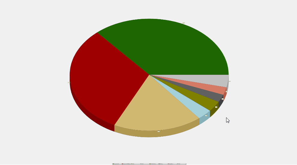

Dear Narcis.
Ok, I managed to bring text and chart (bitmap) together on one printed export.
Anyway, when using your workaround the resolution of the printed export is not as good as when using PrintPartial.
This is because, when generating the bitmap, we use the dimensions of the TChart component. For printing the dimensions of the printer are used, since we want to use the whole page.
In case of using the dimensions of the printer also for exporting the bitmap, the hints and the legend are shown unreadable small (See attachment).
Best regards.
pie chart with unreadable small hint and legend
