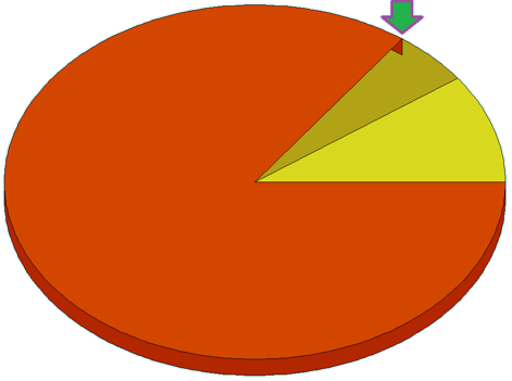

Sometimes the pie chart is not drawn correctly.

I´m using TeeChart Pro V2011.04.41118 for Delphi XE (update 1)
See picture:

Hi NatSam,
Thanks for reporting. I could reproduce the problem here dropping a chart into a form and using the code snippet below so I added it (TV52016045) to the defect list to be fixed.
uses Series;
  Chart1.AddSeries(TPieSeries.Create(Self));
  Chart1[0].Add(10);
  Chart1[0].Add(10);
  Chart1[0].Add(80);
