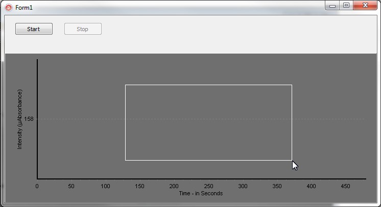

I've changed the timer event handler code to disable the timer in my example after generating a single point, to more easily generate the condition that allows the issue to arise.
Your example is missing a key element which (I believe) is causing the issue. My understanding is that the primary reason the scaling issue comes up is that there is in fact only a single point in the chart, and because axis autoscaling is enabled. I've attached a screenshot showing what the chart looks like just before the Range Error happens (I changed the colors to enhance contrast). As you can see the left axis has no discernible scaling cues because it has only a single point in the chart, and I believe zooming in when in this state is what is causing the problem.
TeEngine.SetMinMax() has the following code which prevents you from setting the axis scale in a range that will illustrate the problem.
So you can't force the issue using SetMinMax().
procedure TForm1.Timer1Timer(Sender: TObject);
if Assigned(serStrip.ParentChart) then
serStrip.ParentChart.AutoRepaint := False;
serStrip.YValue[iChartPointCount] := Random(200);
serStrip.ValueColor[iChartPointCount] := serStrip.SeriesColor;
serStrip.ParentChart.AutoRepaint := True;
if not serStrip.ParentChart.Zoom.Active then
serStrip.ParentChart.Invalidate;
PostMessage(serStrip.ParentChart.Handle, WM_PAINT, 0, 0);
Timer1.Enabled := False;
btnStart.Enabled := True;
btnStop.Enabled := False;
if (FMaximumValue-FMinimumValue)<MinAxisRange then
InternalSetMaximum(FMinimumValue+MinAxisRange);
- JustB4RangeError.jpg (32.35 KiB) Viewed 8017 times
