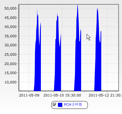

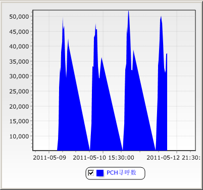

You case see the different in attachment

- the unqualified value are not added.

- the unqualified value are replace by NULL
