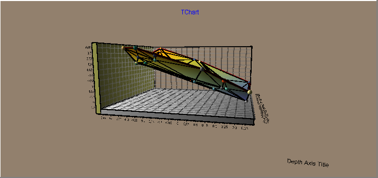

i don't mean the scale. The Title isn't displayed with opengl.
Thanks in advance,
Dennis
Re: depth right axis title isn' t displayed with opengl
Post by Yeray » Tue Jan 31, 2012 11:58 am
Hi Dennis,
Right! Excuse me.
I've seen it's actually drawn, but in a wrong position:
I've also seen it was a know bug already present in the defect list (TV52012692). I've incremented its priority.
