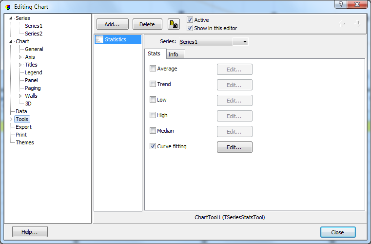

- Statistics tool dialog
- Capture1.png (44.1 KiB) Viewed 20059 times

What I suppose I mean by 'dynamic solution' is I want to add the series and the curve fitting tool at design time - your solution is dynamic because the curve fitting class is instantiated at run time when the form is created.
I can add a curve fitting tool to my graph at design time and point it at a series but I can't make the curve fitting series display!
Your code snippet works fine but I want to be able to do it at design time and not have to dynamically add any code.

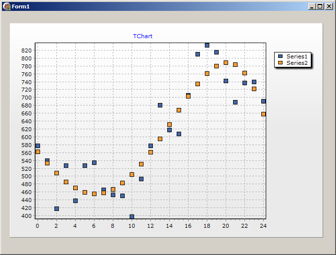

With this, when I run the application, I see exactly the same I see at designtime: Now, if you add some more values to Series1, for example adding a button that does this:
When you run this button Series1 has new values, but the function(s) in the Statistics tool don't know that so you have to refresh their source.
In the case above, we know Series1 (the source) has the index 0 and the Series2 (the series linked to the Curve fitting function) has the index 1. Then you should call the following at the end of Button1Click:

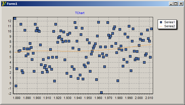

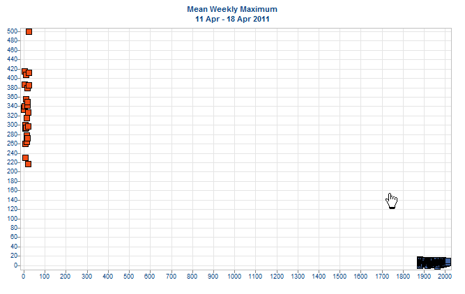

Sorry for not replying yesterday. Thanks for your steps to add a curve they work fine but it still does not fix my problem although I can now plot a curve!
The embedded image (1) shows you the problem - I plot a scattered temperature series for the years between 1878 and 2012 from a list of randomly sorted values like this:

Because the chart auto-scales the real values are huddled up on the right whilst the best fit curve starts at 0 and plots 25 values on the extreme left with Y values that don't bear any relation to those of the temperature values which are always around 10-13.
I then decided to save the data and load it manually as space delimited text (file attached) and got the results you see in the second screen shot (2).
Should the series be sorted for the curve fitting to work and why are the results so high?

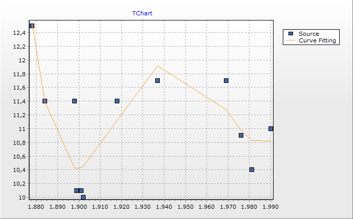

I'm trying to reproduce the problem with an as simple as possible example, but it seems to work fine for me here. Could you please try it?
If it gives you the same result than me, maybe you can find the relevant difference between this example and your application.
I you don't find it, please, try to arrange a simple example project we can run as-is to reproduce the problem here.
uses CurvFitt, Series;
var curveFitFunct: TCurveFittingFunction;
curveFitSEries: TFastLineSeries;
Chart1.View3D:=false;
with Chart1.AddSeries(TPointSeries) do
Title:='Source';
AddXY(1878, 12.5);
AddXY(1969, 11.7);
AddXY(1990, 11.0);
AddXY(1898, 11.4);
AddXY(1918, 11.4);
AddXY(1884, 11.4);
AddXY(1899, 10.1);
AddXY(1901, 10.1);
AddXY(1976, 10.9);
AddXY(1902, 10.0);
AddXY(1937, 11.7);
AddXY(1981, 10.4);
curveFitFunct:=TCurveFittingFunction.Create(Self);
curveFitSeries:=Chart1.AddSeries(TFastLineSeries) as TFastLineSeries;
curveFitSeries.FunctionType:=curveFitFunct;
with curveFitSeries do
DataSource:=Chart1[0];
Title:='Curve Fitting';
