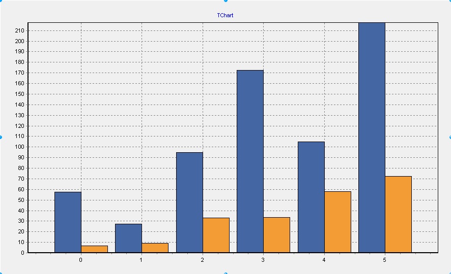

My particular context at the moment is 2D bar charts with a smoothed line series. Marks are useless with precise functions, since there would ideally be one point calculated per horizontal pixel. In any case, marks are not relevant to the issue, as you'll see from my example. To reproduce, simply drop a TChart on a form and add series with the default, random data.
In Figure 1, we have 2 bar series.

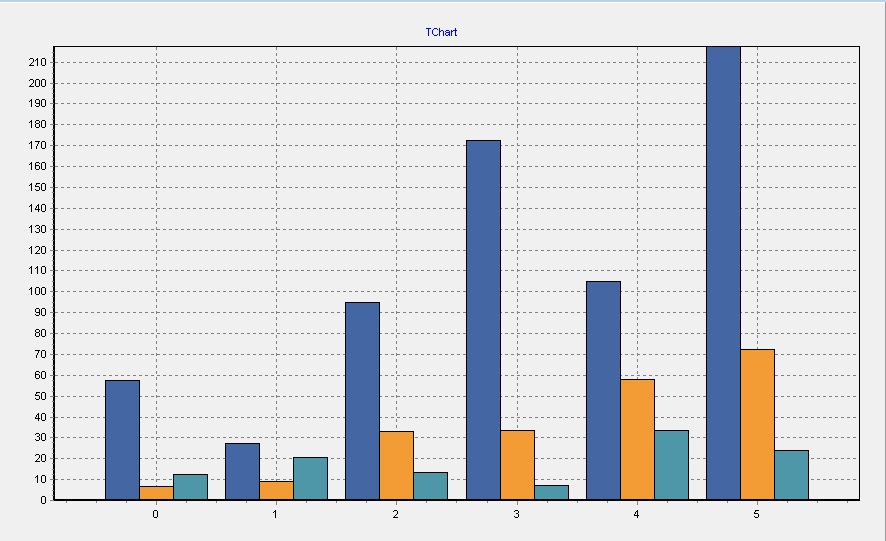

In Figure 2, we've added a 3rd bar series, and the widths have adjusted by being reduced by 1/3, as we would expect, so that the width of all bars collectively remains the same.

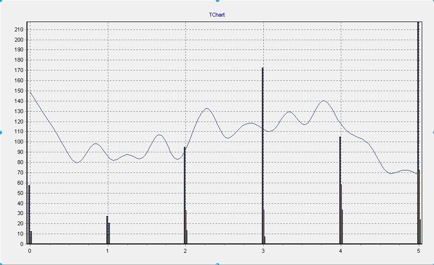

In figure 3, we add a smoothed line series. The bar widths collapse almost to a single pixel, and the collective width of all bars has shrunk disproportionally to a very low level.
Interestingly, adding more line series has no effect on auto bar width - the effect is immediately total, unlike adding bar series, where bars only gradually and proportionally narrow.
Arguably, a line series should have no effect on bar series widths, as they do not compete for space on the bottom axis. A naive implementation would have the introduction of a line series reduce the auto bar width proportionally, as if the line series were being counted as a bar series. But reducing the auto bar width to nearly nothing and rendering them unreadable is not a reasonable nor a naive implementation. Also, it clearly runs contrary to the intent of the auto-bar width feature, which is to have useful bar widths when possible.

Trusler wrote:In figure 3, we add a smoothed line series. The bar widths collapse almost to a single pixel, and the collective width of all bars has shrunk disproportionally to a very low level.
Trusler wrote: Interestingly, adding more line series has no effect on auto bar width - the effect is immediately total, unlike adding bar series, where bars only gradually and proportionally narrow.

The recalcBarWidths procedure is doing something very similar than what TeeChart does internally to calculate the Bars widths when AutoBarSize=true.
The main difference is that TeeChart sources are considering all the series to get "nValues", not only the TBarSeries as above.
So, TeeChart is also considering the number of points in the smoothed line to calculate the bars width.
