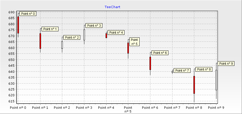

Find below an example where both features seem to work as expected in VB6 with the latest version v2011.0.0.5:

I see you translated the majority of the code from VB to Delphi without too much problems. However, I don't see the equivalent for the InternalRepaint call. Note, you need to be sure the chart has just been drawn so the CalcXPosValue & CalcYPosValue can work as expected. Anyway, maybe in your complete code you ensure it before calling the MarksSetPosition procedure.
I've tried your code (with some little adjustments) in a new simple application and it seems to work fine for me here, also with XE + TeeChart v2011.03.
testCandleMarks.zip
(2.07 KiB) Downloaded 324 times
