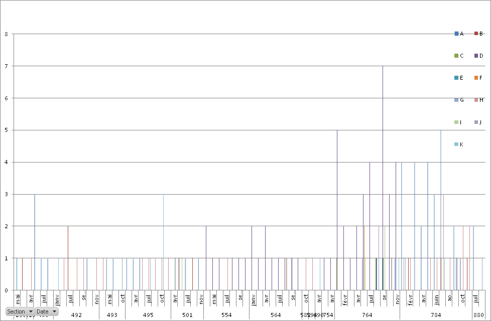

I'm trying to show a tdbchart with "multi x label". Is it possible ?

Hi CLU,
The easiest solution I can think of is that if you have more than one series you add a custom horizontal axis for one of them setting different label styles for each axis and positioning them as desired. You'll find more information on axis setting in tutorial 4. Tutorials can be found at TeeChart's program group.
