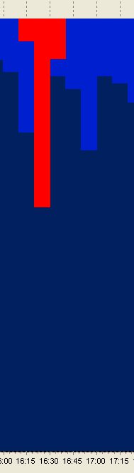

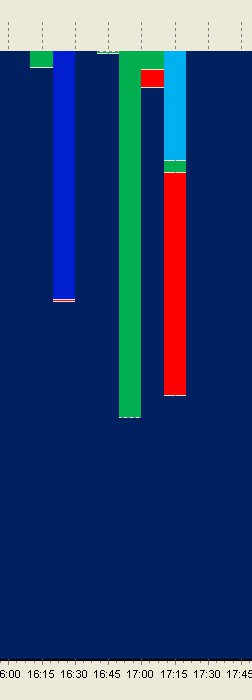

I have updated TeeChart from the Version shipped with Delphi 7 to the current. Now I get little white lines between my bars. See Attachments. How can I remove them to have the old look again.
If I set AreaLinesPen.Visible := true the white lines disappear but all bars are a bit to large.

I've added it to the wish list to be revised for further releases (TV52015938).
This seems to have changed in v5.
