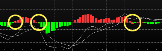

I'm using TFastLineSeries and TBarSeries to implement a MACD chart.
I tried to paint bars with different colors in BarStyle Event but the SeriesColor property
is wrong every time the bar direction invert.
How can I correct this problem? thank you.

Right, when OnBarStyle event is executed, the brush color is already assigned for the current point so it doesn't take effect until the next point is going to be drawn.
Why don't you set a color for each bar in the series ValueColor array? With it, you only have to set the pen color at the OnBarStyle event.

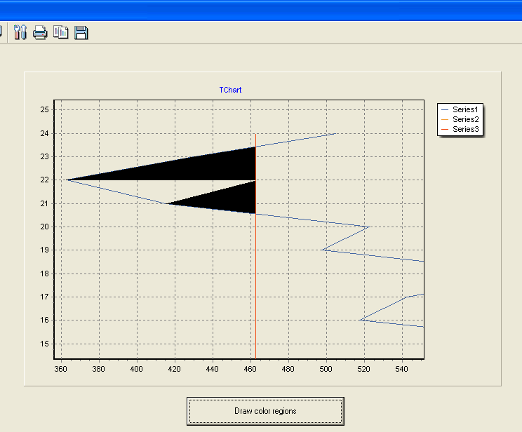

Thank you very much for this. I tested it here under D2007 and TeeChart 2011.03.30407 and is some cases it does not work as expected (see attached picture). Can you please confirm this?
Re: A problem with bar color, please help.
Post by Yeray » Tue Dec 13, 2011 9:27 am
johnnix wrote:I tested it here under D2007 and TeeChart 2011.03.30407 and is some cases it does not work as expected (see attached picture). Can you please confirm this?
Right. There was a problem in the CrossPoints function (concretely at TCrossPointsFunction.AddPoints method) that was giving some wrong points. I've just revised and fixed it for the next maintenance release (TV52015960).

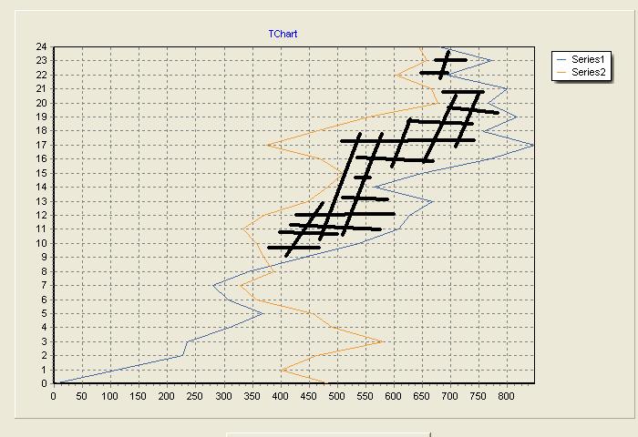

I tried to modify the example so that it can work with 2 Horizontal lines series but it does not work as expected. Is it too much to ask for a sample code? I need to paint the hatched region only. Maybe this could also included in the Tools section?
Post by Yeray » Thu Dec 15, 2011 11:23 am
Hello Johnnix,
I'm afraid the TSeriesBandTool doesn't differentiate the regions where the first series is greater than the regions where it's lower. I've added to the wish list the possibility to add two brushes to this tool. One brush would be used to draw the "positive" polygon and the other to draw the "negative" polygon (TV52015967).
This would allow you to set one of the brushes to bsClear, that, if I understood well, would fit your requirement.
In the meanwhile, I'm afraid you should calculate the region polygon and draw it manually. You could use the CalcXPos and CalcYPos methods to get the polygon points, and you could calculate the cross point(s) using the TCrossPointsFunction in a similar way than in the examples above.
