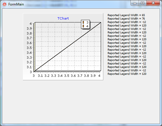

See attached picture. I produced this by :

Keep in mind that whatever manner it is calculating the legend width, it seems to breakable - it isn't actually '-12' at any point in time - in the example I used, it is flicking between displaying the information for one or two series.
Perhaps it needs to resort to some cache value if certain other values are invalid for it to use in the width calculation, or if it is halfway through an update.
