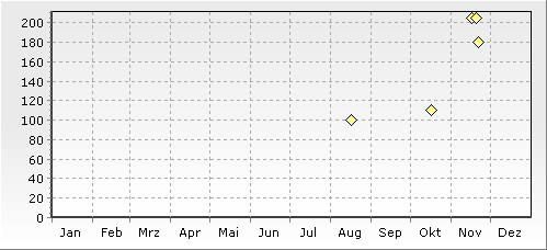

Hi Alex,
I'm afraid you can't add an offset to the axis labels. We will consider including both an horizontal and vertical offset in a future version (TV52015940).
In the meanwhile, you can simply add some blank spaces ' ' at the beginning of your month strings. Depending on how are you exactly showing the labels, it should be done in the OnGetAxisLabel if you are using the default labels or just modifying the ShortMonthNames array.
I've checked it with the following code and it seems to work fine for me here:
uses Series;
var i: Integer;
    tmpDate: TDateTime;
const space='         ';
  Chart1.View3D:=false;
  Chart1.Legend.Visible:=false;
  Chart1.Title.Visible:=false;
  with Chart1.AddSeries(TPointSeries) as TPointSeries do
    Pointer.Style:=psDiamond;
    Pointer.HorizSize:=5;
    Pointer.VertSize:=5;
    Pointer.Gradient.Visible:=true;
    Color:=clYellow;
    XValues.DateTime:=true;
    AddXY(StrToDateTime('17/08/2011'), 100);
    AddXY(StrToDateTime('17/10/2011'), 110);
    AddXY(StrToDateTime('17/11/2011'), 205);
    AddXY(StrToDateTime('20/11/2011'), 205);
    AddXY(StrToDateTime('22/11/2011'), 180);
  Chart1.Axes.Left.AutomaticMinimum:=false;
  Chart1.Axes.Left.Minimum:=0;
  Chart1.Axes.Bottom.SetMinMax(StrToDateTime('01/01/2011'), StrToDateTime('01/01/2012'));
  Chart1.Axes.Bottom.DateTimeFormat:='mmm';
  Chart1.Axes.Bottom.MinorTicks.Visible:=false;
  ShortMonthNames[1]:='Jan';
  ShortMonthNames[2]:='Feb';
  ShortMonthNames[3]:='Mrz';
  ShortMonthNames[4]:='Apr';
  ShortMonthNames[5]:='Mai';
  ShortMonthNames[6]:='Jun';
  ShortMonthNames[7]:='Jul';
  ShortMonthNames[8]:='Aug';
  ShortMonthNames[9]:='Sep';
  ShortMonthNames[10]:='Okt';
  ShortMonthNames[11]:='Nov';
  ShortMonthNames[12]:='Dez';
  Chart1.Axes.Bottom.Items.Clear;
  tmpDate:=Chart1.Axes.Bottom.Minimum;
  for i:=Low(ShortMonthNames) to High(ShortMonthNames) do
    Chart1.Axes.Bottom.Items.Add(tmpDate, space + ShortMonthNames[i]);
    tmpDate:=IncMonth(tmpDate);
AlexD
Posts: 3
Joined: Thu Apr 01, 2010 12:00 am
Re: Values / labels within a period, not at a certain mark
Post by AlexD » Mon Dec 05, 2011 3:51 pm
it didn't work in the OnGetAxisLabel event, but then I've used this part of your code
after my chart was generated and it did work just fine.
Thanks a lot for your help and also for considering the addion of label offsets as a new feature!
