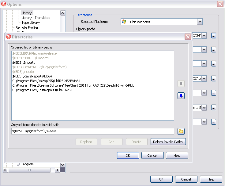

The path to the Delphi16.win64\Lib is set, see image

Ok, that should suffice. You could try moving it to the top of the list though.
I can also see that you have FastReports installed. Disabling them lets your 64-bit TeeChart applications being build? If that's the case probably FastReports uses TeeChart packages and you should update them to the current TeeChart version.

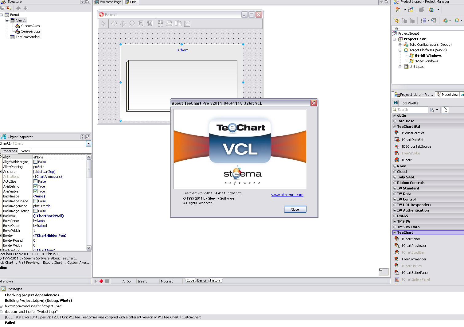

Hello!
I thought that my problems are connected with some installation conflicts, because when I added TeeCommander to my empty 64 bit project it failed to compile with the error
[DCC Fatal Error] Unit1.pas(7): F2051 Unit VCLTee.TeeComma was compiled with a different version of VCLTee.Chart.TCustomChart
There are some facts that could drop the light to the problem.
1.To install TChart I used the binary installer. Before the installation I hadn't manually uninstalled the TChart Std from the XE2 Update 2 Package. Should I? Now TChart component is located in TeeChart Std group in the Component Panel (see the screenshot). I also have TeeChart group with additional components. Is it normal? About box shows that I use TeeChart Pro 32 bit VCL. Is it correct for the 64 bit project?
2. I also have Delphi 2010 with TeeChart Pro for Delphi 2010 installed. Could it produce errors?
3. 32 bit applications are compiled and work fine.

Eventually I've solved the problem by myself. I uninstalled TeeChart Pro, downloaded Full Source version and installed it by Recompile utility. I think that the problem was connected with TeeChart Std bpls located in the search path as I was prompted by Recompile.
