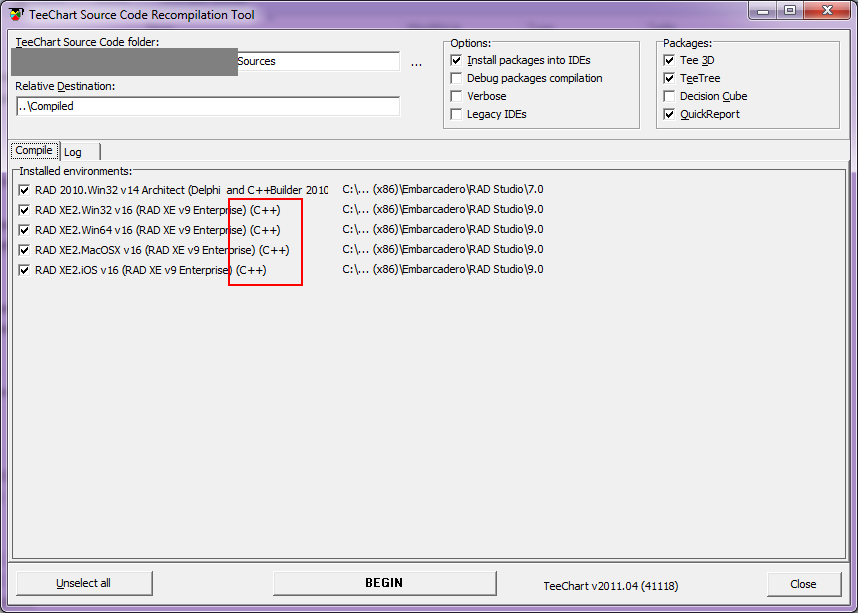

Yeray wrote: TeeRecompile usually shows 4 entries for XE2 (Win32, Win64, MacOSX and iOS). If TeeRecompile only shows one entry it may be finding just one of the personalities.
TeeRecompile shows 4 entries but between parenthesis, at the end of the compiler line, it only shows (C++) (see attached screenshot)
Screenshot of TeeRecompile on my machine.
Pierre Y.

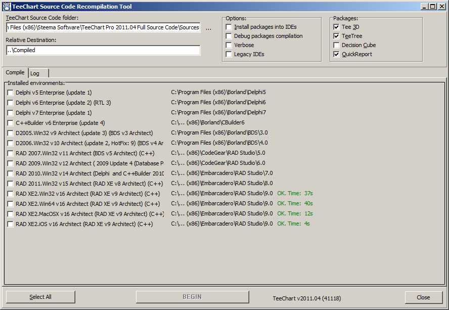

Re: TeeChart 2011.04 Pro With Source Code installation fails
Post by Yeray » Wed Nov 23, 2011 4:33 pm
Hello Pierre,
The "(C++)" in the string that identifies the IDE is normal. It just indicates that the IDE has a C++ personality. It's also in the RAD2010 checkbox but this string is so long that it's partially hidden. The RADXE2 strings is one of the things we want to clean for the next maintenance releases.
However, as you can see in my screenshot, it works fine for me here.
