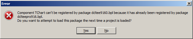

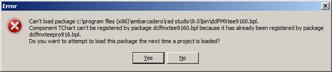

After the repair, I've opened the IDE and I get the following messages:

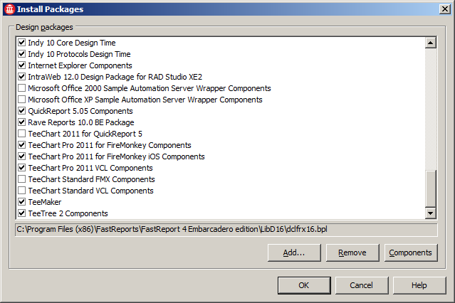

I answered "No" to both messages above and the IDE opened normally. I've visited the packages list and the Pro packages are still installed (the Standard packages are listed but unselected for me):
And the component seems to work normally in a new VCL, FMX or FMI application.

I've run TeeInstall.exe to uninstall TeeChart Pro. After doing it, I've opened the IDE to clean any remaining TeeChart path from the library, include,... lists (in "Tools/Options") and I've removed the "TeeChart for iOS" and "TeeMaker" packages from the packages list. I hope the installer can do it automatically in next versions.
Then I closed and repaired the IDE. After it, I could open the IDE with no error message. In the packages list, I see the TeeChart Standard packages listed but unselected ("TeeChart Standard FMX Components" and "TeeChart Standard VCL Components"). Checking them, both a new VCL and FMX applications with a chart on the form work fine for me here.
