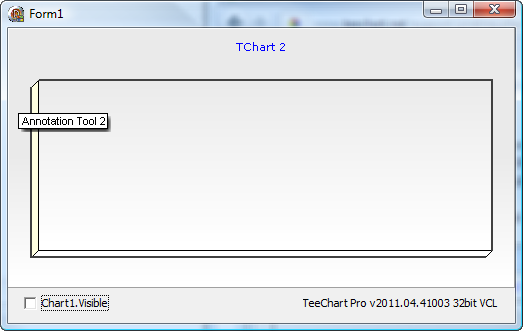

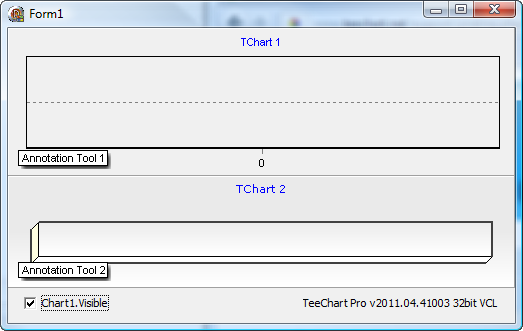

In the attached sample project I have 2 chart with 2 Annotation tools with a custom position.
Following advise in this forum the position of the Annotation tool is set in the OnAfterDraw event of the chart.
With the checkbox Chart1 can be made (in)visible. In the following OnAfterDraw event the Annotation tool is not drawn in the correct position, only after a second OnAfterDraw event.
What do I have to do to draw the Annotion tool in the correct place after (un)checking the checkbox?
