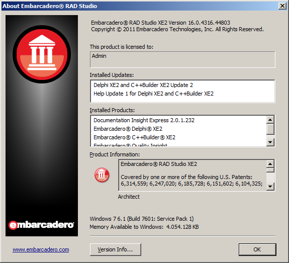

Post by Yeray » Thu Nov 03, 2011 11:42 am
Hello Gregg,
What version of RAD Studio XE2 do you have?
Mine is 16.0.4316.44803:

Post by Gregg » Thu Nov 03, 2011 12:23 pm
My version is the same as yours 16.0.4.44803.
