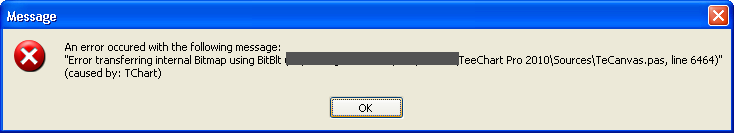

My application is running fine for several years now on many clients but today for the very first time a client reported an error (See attached picture). What could be the issue here provided the fact that the application works ok on so many machines?

Ok, here is an update. The user just reported that when my application starts they first receive the attached error (app is running on a WinXP SP3 machine).
We are aware of a similar issue (TV52015296) which was discussed in this thread. Can you please ask your client if they reproduced the issue in similar circumstances?
Could you please provide more detailed information or an example project to reproduce the problem here?

I will see if the user wished to run a test app and reproduce the error. I am not able to reproduce the error here

Is there any work around for this error at all? Unfortunately I lost this client :(

An option is try compiling the application with assertions disabled as explained at the thread I pointed you.
