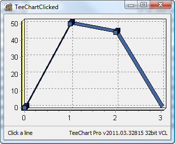

If I set TLineSeries.Pointer.Visible to True, the last point of the serie is missing.
The bug has been introduced by version 2011.03.32815 as far as I can see.
The Tee9new demo application (dated 16-11-2010) is okay.
Bert
