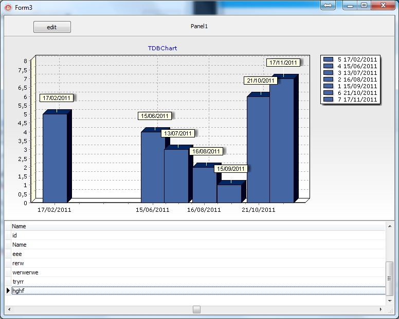

I have a series grouped by month.
I want it to sorted correctly.
How?

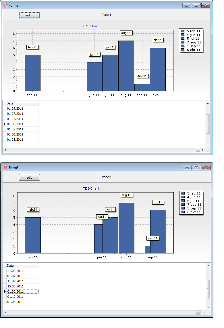

Post by jls » Fri Sep 23, 2011 8:19 pm
Think it is tha same for me if it is first, midle or last day in the month, the problem is that it doesn't work like this for me. It uses the actual date. Take a look at the second image.

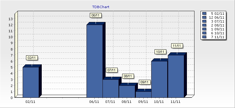

Which produces this chart:
Is that what you expected? Notice there are some more DateTime grouping options now.

Post by jls » Fri Sep 30, 2011 7:30 am
This is exactly what I want,
