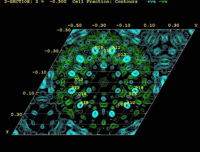

non-orthogonal contour map
Hello
Most contour maps are with respect to orthogonal axes, but sometimes one needs to plot them with non-orthogonal axes i.e. axes that are not perpendicular to each other.
