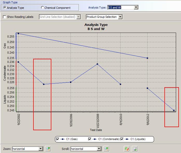

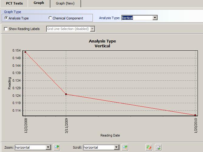

This is how the original graph looks like

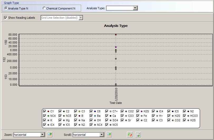

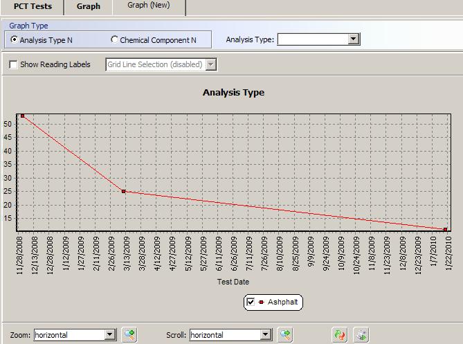

This is how my new graph looks like
My main concern at this point is the following:
I need my new graph to only show bottom axis label for where there are records (just like the first one)
I need the graph to show xy axis labels where there are records (just like the first one)
I need the left margin to adjust automatically to show the full reading labels and axis titles (just like the first one)
Please advise, I need this ASAP since we're supposed to release soon!

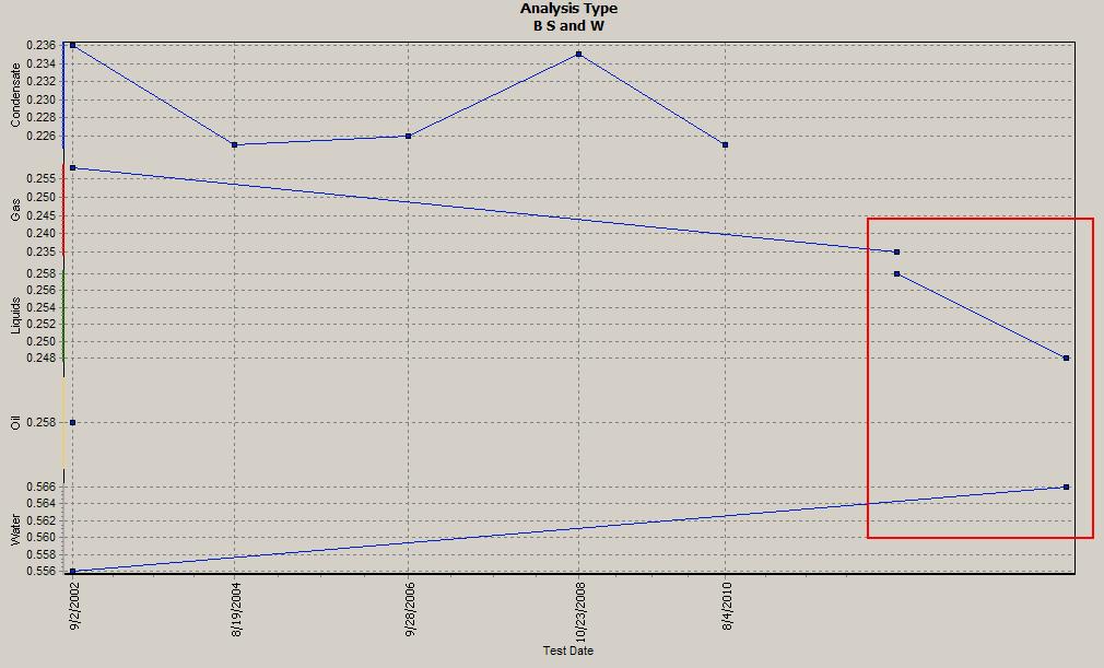

I am nearly ready to finalize the graph, but I do require some assistance with one rather annoying issue:
I highlighted which values are not showing on the grid/bottom axis.
The values are there but for some reason they don't always show on the axis. I need them to be there.
Is there a way I can force this to happen? I have the ShowAllLables enabled on the bottom axis (in the Chart wizard, not in code).
As I disable so of the Product Type (Gas, Condensate, Liquids) they values start appearing on the bottom axis, so I know the graph "knows" what they are!
For example if I disable Gas I can see ALL the labels for the Condensate axis but none of the Liquids axis labels, but when I only have the Liquids enabled I see all of it's labels.

It, just like the other way around, works just fine. Adds correct values to correct axes and series, just the labels are still missing from some values :(
