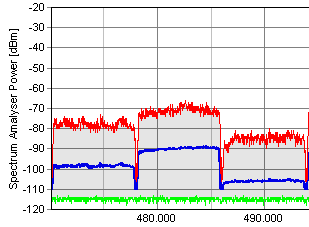

A Chart tool calculates a band between tow series.
On "TeeGDIPlus1.Active := false;" this works pretty good but on "TeeGDIPlus1.Active := true" the band has been switched off or to transparent color.
How can I fix this?
This pictures show the difference if TeeGDIPlus1.Active is set.

It seems to work fine for me here with the latest version (v2011.03), both running the demo under All features\Welcome !\Tools\Series Band and a simple example application with the following code:
uses Series, TeeSeriesBandTool, TeeGDIPlus;
  Chart1.Canvas:=TGDIPlusCanvas.Create;
  Chart1.View3D:=false;
  Chart1.AddSeries(TLineSeries).FillSampleValues();
  with Chart1.Tools.Add(TSeriesBandTool) as TSeriesBandTool do
    Series:=Chart1[0];
    Series2:=Chart1[1];
    Gradient.Visible:=true;
    Transparency:=50;
PS: I've moved this topic to the TeeChart\VCL forums.

For me it looks like an inverted tape color.
I've changed the chart.tool.transparence to 50%.
On GDI+=off I can see the expected grey tape.
On GDI+=ON now I see a transparent white tape.
How can I change the tool.tape color on running time?
This might solve my problem?

You can change the tool color with its property Brush.BackColor. But note that this will only be applied when the tool property Gradient.Visible is false.
What TeeChart version are you using?

The tip does not work here but I found a solution.
I've set the the tool gradient twice to grey.
This has been "solved" the problem.
I do use the April 11 version.
