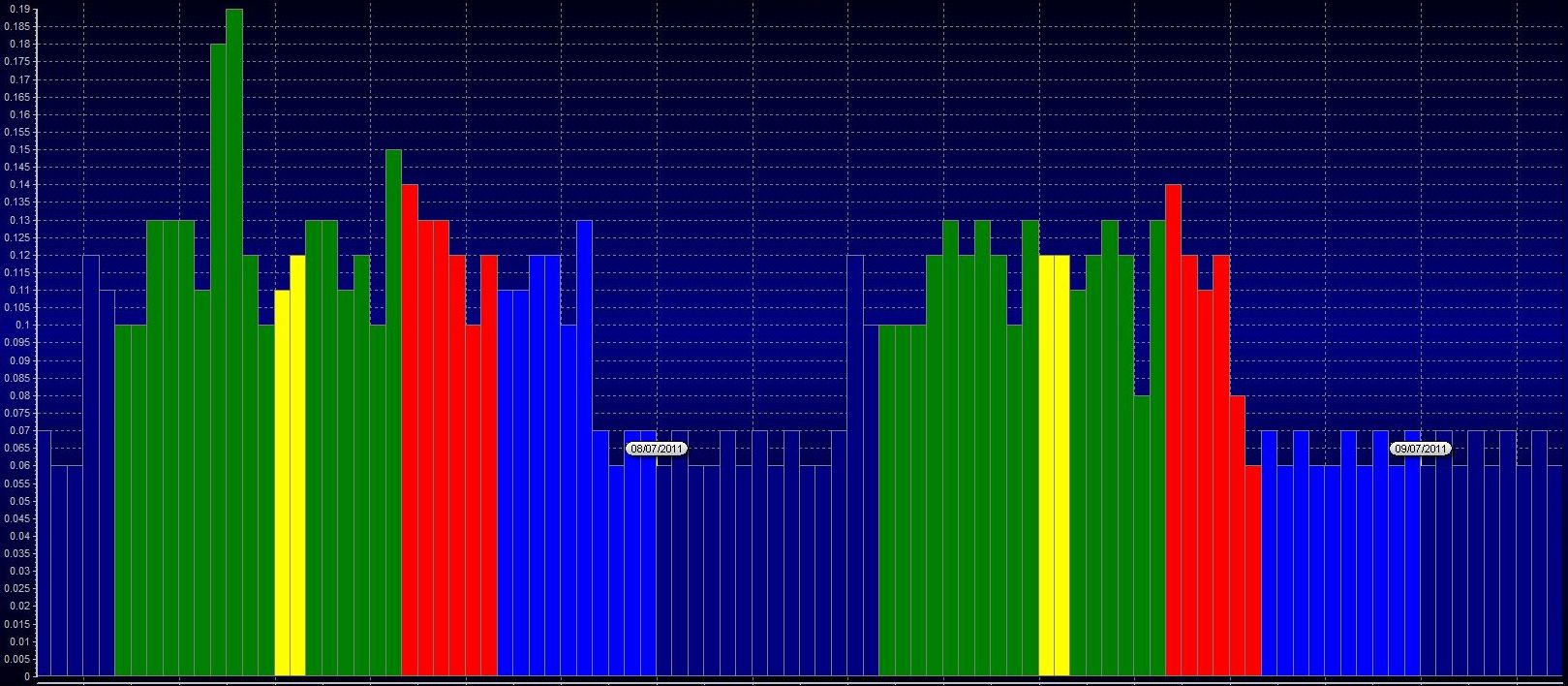

There seems to be a problem with the zoom function in v2011. I display a chart with around 1500 bars and allow the user to zoom in using the mouse, in the standard fashion but restricted to horizontal zoom only.
This is how it used to look in v8 (zoomed in to show 2 out of 30 days) :-
This is how the v8 zoom looked
Old Zoom.jpg (205.32 KiB) Viewed 13133 times

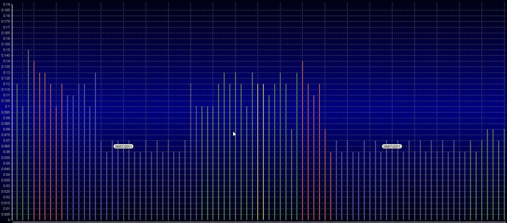

This is how it looks in v2011 (also showing approx 2 out of 30 days) :-
New Zoom.jpg (286.87 KiB) Viewed 13116 times
Is there a way to change this behaviour?

Hello Jamie,
You could try setting (being Series1 your TBarSeries):
Series1.AutoBarSize:=true;

Hi Yeray
Thanks, that seems to have improved the situation.
The effect is not exactly what I was after (either before zoom or during), as I wanted the bars to be drawn without gaps, but it is much better than setting the bar width to 100% (as I was before).

Hello Jamie,
Taking another look to this, I've observed some problems with BarWidthPercent that seem to be introduced with the quite big modifications applied to the Bar series in the v2010.02.
1. The Bars may look superposed.
2. If you zoom, the bars become separated. If you have a lot of bars, AutoBarSize=true fixes the problem for moderated zooms.
3. If you set AutoBarSize=true, the problems above still happen with a few bars, and a new one appears: if you scroll the chart, the bars become thinner and separated.
These problems are less evident with a lot of bars, so in your case you may not be very affected for them, but I've added them to the defect list to be fixed in future releases (TV52015681).
