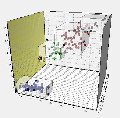

I am currently using TChart 2011 and I'd like to draw multiple
semi-transparent rectangles with different X,Y,Z extends like
shown in the clustering example.

I'd like to draw, right like in the given plot, boxes around clustered Items in a PCA score plot.
And I know the X,Y,Z coordinates of all cluster centers as well as the extend of each cluster in PCA score coordinates.

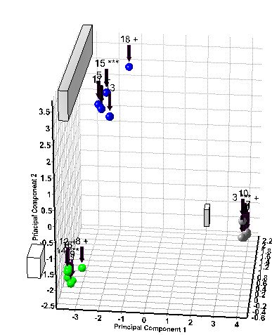

Now I tried the approach that was suggested by Narcis, drawing cubes in the TChart OnAfterDraw event.
In this case the extends of the cubes seem to be OK but now the positions are off.
This is the code that was used to convert from PCA score coordinates to drawing coordinates/pixels;
    for i := 1 to NrOfRows do
      if FClusterAnalyser.IsDataSetARepresentant(i - 1) then
        IsItemInClusters(FClusterAnalyser.Clusters, i, ClusterIndex);
        if not FClusterAnalyser.Clusters[ClusterIndex][0].Hide then
          // Get Cluster extend in pixels
          XSize := PCAChart.BottomAxis.CalcSizeValue(FClusterAnalyser.GetMaxDistanceX(ClusterIndex));
          YSize := PCAChart.LeftAxis.CalcSizeValue(FClusterAnalyser.GetMaxDistanceY(ClusterIndex));
          ZSize := PCAChart.DepthAxis.CalcSizeValue(FClusterAnalyser.GetMaxDistanceZ(ClusterIndex));
          // Get Cluster center in pixels
          FClusterAnalyser.CalculateCenterOfCluster(ClusterIndex, Xc, Yc, Zc);
          XCenter := PCAChart.BottomAxis.CalcSizeValue(Xc - PCAChart.BottomAxis.Minimum);
          YCenter := PCAChart.LeftAxis.CalcSizeValue(Yc - PCAChart.LeftAxis.Minimum);
          ZCenter := PCAChart.DepthAxis.CalcSizeValue(Zc - PCAChart.DepthAxis.Minimum);
          DeltaY := PCAChart.LeftAxis.CalcSizeValue(PCAChart.LeftAxis.Maximum - PCAChart.LeftAxis.Minimum);
          // Prepare drawing
          Rect := TeeRect( Round(XCenter - (XSize / 2)),
                          -Round(YCenter - (YSize / 2)) + DeltaY,
                           Round(XCenter + (XSize / 2)),
                          -Round(YCenter + (YSize / 2)) + DeltaY);
          Z1 := Round(ZCenter - (ZSize / 2));
          Z0 := Round(ZCenter + (ZSize / 2));
          PCAChart.Canvas.Cube(Rect, Z0, Z1);
Here is the resulting drawing:
I know that the center coordinates returned by:
are correct!
Can you maybe tell me what I am doing wrong in the conversion from coordinates to Pixels?
best regards,
X-Ray
