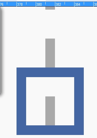

Re: To raw point size increment
Post by Narcís » Thu Jun 30, 2011 1:42 pm
Hi Andreas,
For this configuration you get an 7x7 rect and NOT 6x6 !
Diameter = Radius * 2 +1 Pixel
One can NEVER create a rectangle with even diameter!
I think this it a big and unnecessary restriction of TeeChart.
Sorry, yes. I checked it better now with this image:
Anyway, this will be investigated for TV52015633.
